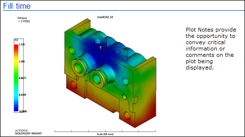

Use the OnePlotwithNotes command to add a single result plot to your report, with its accompanying plot notes.
