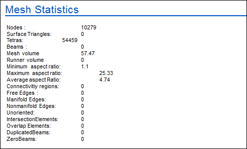

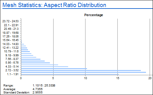

Report mesh information
Use the MeshInformation command to include mesh statistics and a plot of the aspect ratio distribution.
The format for the mesh information command is:
MeshInformation, <Advanced>, where <Advanced> is optional.
This command reports the mesh statistics. It also plots the aspect ratio, if Advanced is invoked. For example:
