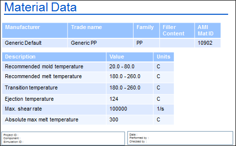

This command reports manufacturer information, including:

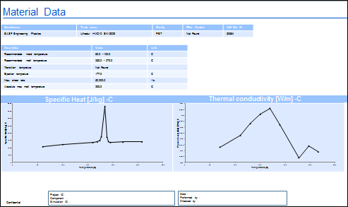

It also reports a variety of recommended processing conditions. For example:
To plot the specific heat and thermal conductivity data, include the Advanced argument:
