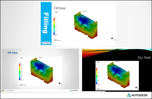

PowerPoint template
The automated custom reports use standard Microsoft PowerPoint templates. The extensions .potm, .potx, and .pot are all supported. Only the Title slide and the Title and Content slide are used. There is no custom slide support.
Edit the templates provided, or create new templates to ensure the report is customized to your requirements. You can add your company logo, or other branding images, using the AddImage, <Image Name>, <Title> argument. <Image Name> should include the full file path and adds the image; <Title> is used to add a title to the slide.
You can change the background, the margins, and where on the slide you want the result plot titles to appear. You can either define the margins in the template, or you can change them in the .rpt file via options.
The default drawing area is:
