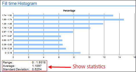

Use the OneHistogram command to include in your report.
The format for the OneHistogram command is:
OneHistogram, <Plot Name>, <Number of Bars>, <Show Statistics>, or
OneHistogram, <ResultID>, <Number of Bars>, <Show Statistics>
where <Show Statistics> is an optional argument.
For example:
