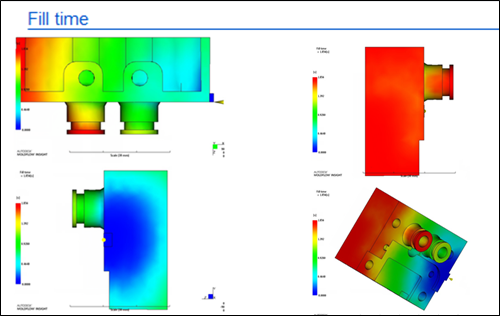

Use the OnePlotFourViews command to add four different aspects of a single result plot to your report.
The format for the OnePlotFourViews command is:
OnePlotFourViews, <Plot Name>, <OrTopLeft>, <OrTopRight>,<OrBottomLeft>,<OrBottomRight>, or
OnePlotFourViews, <ResultID>, <OrTopLeft>, <OrTopRight>,<OrBottomLeft>,<OrBottomRight>,
where the <Orientation> arguments are optional. If you use a saved view that you have created yourself, include quotation marks around the orientation arguments.
Inputs for the Orientation arguments include:
For example:
