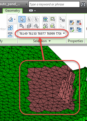

Triangular elements are three-noded elements used to model surfaces for Dual Domain and Midplane meshes.
Triangular elements are assigned the identification label 'T'. When you select triangles, the identifiers, which are comprised of the letter T followed by a number, are listed in the selection list.
