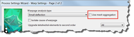

Some results are only available when you turn mesh aggregation off.
Molded-in residual stress results, such as the
Stress tensor (warp) result, are only available when the residual stress model is selected and mesh aggregation is turned off.
Click
(Home tab > Molding Process Setup panel > Analysis Sequence) and choose a sequence that includes
Warp.
Click
(Home tab > Molding Process Setup > Process Settings).
If necessary, click
Next until you reach the
Warp Settings page.
Set the
Warpage analysis type to
Small deflection.
