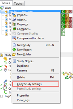

- Open the project containing the studies you are working with.
- Select the original study, click the right-hand mouse button and select
Copy Study settings from the context menu. Notice that the
Paste Study settings option, below it, is not active at this stage.
- Select the target study, click the right-hand mouse button and select
Paste Study settings from the context menu, which is now active.
