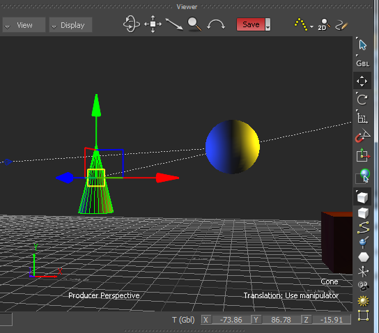

The Viewer window Manipulation and Transformation mode tools let you activate the Translation, Rotation, or Scaling modes.
Select Translate
to activate
Translation mode and move the selected object according to the Reference mode you have selected.
Translation mode lets you translate objects using the Translation arrows, and by entering values or dragging in the X, Y, and Z fields. For more information about translating objects, see About translation.
You can move multiple objects in their own respective local space using the translation tool. To do so, Local Reference mode must be active.
