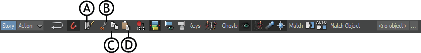

Edit buttons A. Razor B. Cut C. Copy D. Paste
| Button | Function |
| Razor | Lets you slice a selected clip in two.
Note: To slice selected clips on multiple tracks at the same time, place the Timeline indicator over the clips and use the Razor option in the context menu instead. See
Razoring clips.
| Cut | Removes selected clips and stores them in memory. You can also use the keyboard short-cut Ctrl-X to cut selected clips. |
| Copy | The Copy button copies selected clips. You can also use the keyboard short-cut Ctrl-C to copy selected clips. |
| Paste | Inserts a copied or cut selection into another location. |

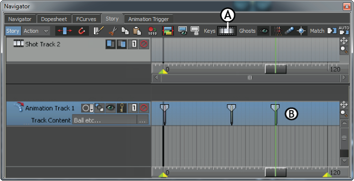

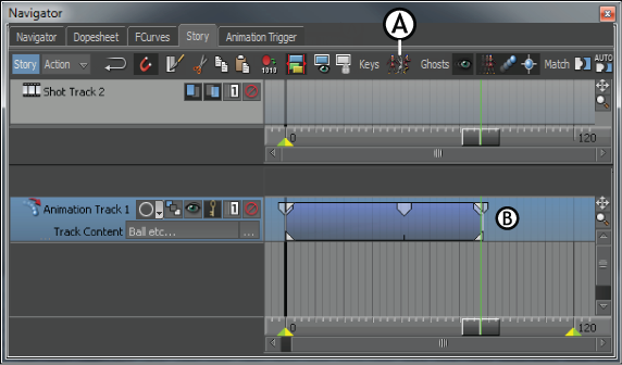

The Multiple Clips option displays when an Animation, Camera Animation, or Character track is selected.
Story window A. Multiple Clips option set to active B. Clips created for keyframes at frame 0, 49, and 81
Story window A. Multiple Clips option disabled B. Clip encompassing keyframes at frame 0, 49, and 81
You can change the contents of a keyless clip by placing the Timeline indicator over it and transforming the selected assets again.

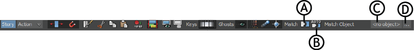

Story controls A. Match Options button B. Auto Match option C. Match Object field D. Match Object button
The Match Controls are active only when an animation, camera animation, or character clip is selected. See Matching clips for more information.
