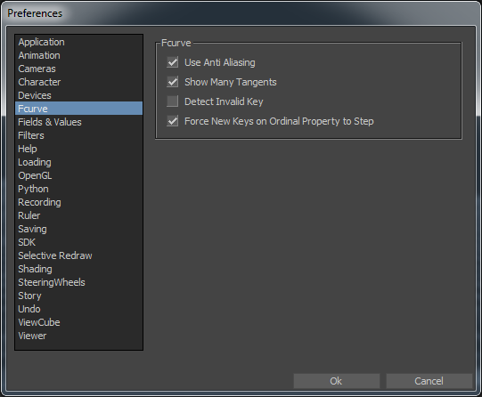

The Preferences window include the FCurves preference settings.
The FCurves preference settings include the options to use anti-aliasing and to display multiple tangents.
To access the FCurves preferences:
Preferences.
The FCurves preference settings display.
FCurves preferences
The following table describes the FCurves preference settings.
FCurves settings |
Description |
Use Anti Aliasing |
When enabled, creates a visual change only, no data is affected. The default option is active. |
| Show Many Tangents |
When enabled, displays multiple tangents. |
When enabled, detects when an invalid key is inserted, and displays an error message if needed. The problematic key value is automatically reset to 0 and can be fixed manually. |
Force New Keys on Ordinal Property to Step |
When enabled (default), keying an ordinal property generates a Step key. |
