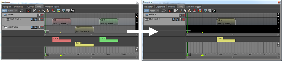

In the following image
Display Minimized Action Shot Clips is on. Shots are still displayed when the folder containing the associated shot clips is collapsed.

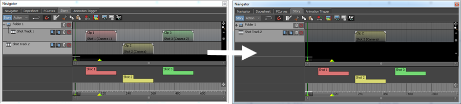

Display Minimized Action Shot Clips is off. Shots are hidden when the folder containing the associated shot clips is collapsed.
