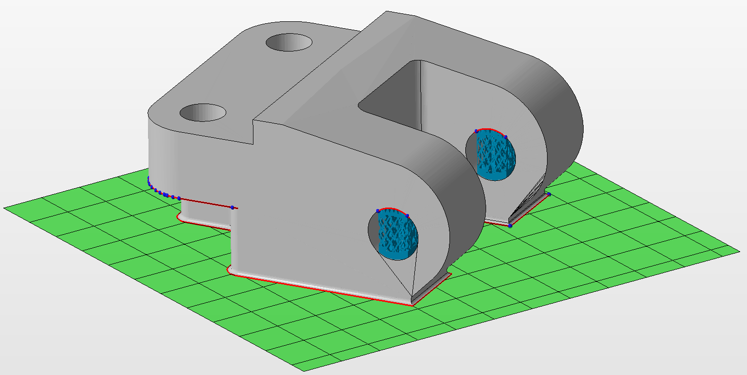

  10. For this instance, it is desired that only the back supports are homogenized. Right-click each of the two curved front supports and choose Remove entity. You may need to do this more than once if you see bits of lattice remaining.

  19. Now delete the back supports which have already been generated and homogenized. Do this by right-clicking and selecting Remove entity.

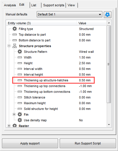

  20. A thickness must be added for the lattice supports to mesh. Select both curved supports by holding down the Ctrl button and clicking the left mouse button.
  21. Switch to the Edit tab in the left pane. Expand the Structure properties menu by pressing the + symbol.
  22. In the Thickening up structure-hatches field, type 0.50. This will create support structure walls approximately 2-3 bead widths wide. Click Apply support.
