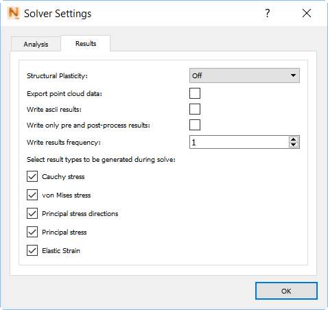

Results tab
Turn structural plasticity on or off, choose results writing options, and select the desired stress and strain result types.
Structural Plasticity does not apply to Thermal analysis, but if you selected Mechanical or Thermal and Mechanical on the Analysis tab, two options are available:
The table below specifies the advantages of each of the Structural Plasticity options and their use cases.

For each selection, you can use check boxes to turn off any unwanted result types.
Select Write ascii results if you want the content of result files <project>.geo, <project>.geoc, and <project>.ens to be in ASCII rather than binary format. ASCII results can be useful in custom optimization routines.
Use the Write only pre- and post-process results option to minimize the number of results saved from the simulation, which reduces the use of disk space. The Write results frequency option offers a more adjustable way to reduce the number of process steps recorded and saved. A value of 1 will write results every step, which is the default setting. A value of 2 will record every other step, 3 every third step and so on. This setting only applies to the process simulation steps. From the cooldown step onward, all post-processing steps, including heat treatment if enabled, will be written.
Select Export point cloud data if you want the system to export a series of 3D data files of the surface nodal simulation results, for post processing. Depending on your structural plasticity setting, you will get some or all of the following files:
