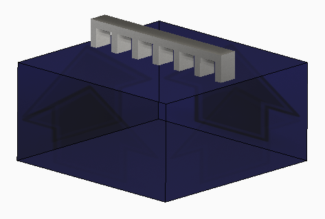

  2. On the Home tab, click Build Plate > Size tab, and enlarge the build plate by changing the X and Y Length values to 50.00 mm.

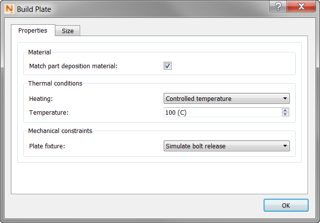

  3. Click Build Plate > Properties tab.
    Note the Heating options available here:
    • None initializes the build plate at the ambient temperature.
    • Initial Temperature assigns the specified temperature at the start of the build, but does not maintain that temperature during processing.
    • Controlled Temperature maintains a set temperature throughout the simulated build process.
  4. Set the Heating value to Controlled temperature, and Temperature to 100.
  5. Set Fixture to Simulate bolt release.
    Plate fixture controls the mechanical boundary conditions. There are three options:
    • Fix the bottom of the build plate fixes nodes on the base of the build plate, at the center of the build plate in X, Y, and Z directions, and constrains all other nodes in the Z direction.
    • Simulate bolt release is used to model the construction of full build plates. It simulates the effect of bolting down each corner of the build plate for the deposition process, then allowing the part to cool down to room temperature, and unbolting the build plate, allowing the build plate to distort. It is used for this particular example to show what effect this option has on the simulation results.
    • Fix the center of the build plate fixes only the build plate center, to model the case of a build plate held in place on the build platform by gravity and friction alone.

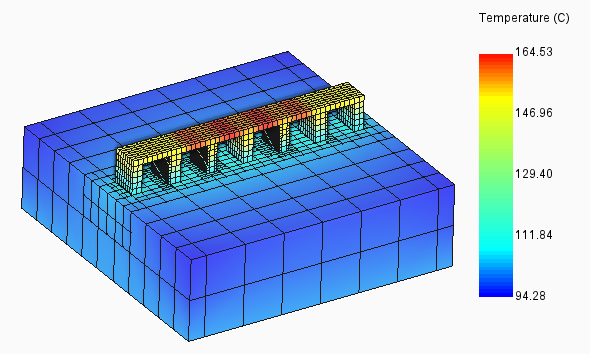

  7. In the Browser, turn on the Temperature results and play through the animation.
    Note that the temperature of the part increases during the build, but the build plate holds a steady temperature until it cools down at the end.

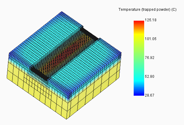

By default, the thermal boundary condition is a static uniform heat flux on the surfaces of the component and build plate. For components that are closely packed together or have hollow walls or similar features where significant heat can be transferred through the powder, the model accuracy can be improved by modeling the powder directly.
  1. On the Home tab, click Operating Conditions, and set the Thermal boundary condition to Conduction to loose powder.
  2. Click Solve to re-run the simulation, and import the results.
    This time, play through the Temperature (trapped powder) results, to observe the effect of including powder elements during processing.
    Extra elements are added to the entire powder bed and we simulate conduction into that material.
