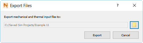

  6. Click Simulation menu > Export.
  7. In the Export Files dialog, click the Browse button, create a new folder in a good location and name it Example 11. Select this folder and back in the Export Files dialog, click Export to save the input files.
    The Example 11 folder opens so that you can see the exported files.

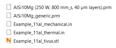

    Simulations executed from a batch.que file proceed serially through the list. The input, PRM, and STL files for each simulation must all be in the same folder as the batch.que file.
  13. Type or copy/paste the names of the 4 exported input files, without the .in file extension, into the Batch.que file, ensuring that each *_thermal file precedes the corresponding *_mechanical file. The resulting batch file should look like this:
    Example_11al_thermal
    Example_11al_mechanical
    Example_11ti_thermal
    Example_11ti_mechanical

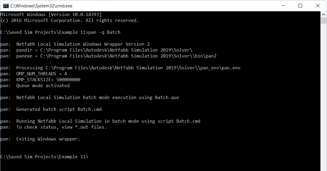

  15. To execute the batch command, type pan -q Batch from the command prompt, and then press Enter.
    pan is the solver executable, -q indicates a batch file will be used for the inputs, and Batch is the name of the .que file, without the file extension. The execution and output returned from the solver should look similar to the following:
    The solver ran the four simulations in sequential order. In the Example 11 folder, you should see .out, .case, and other output files for each simulation.
