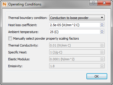

  4. Open Operating Conditions and set Thermal boundary condition to Conduction to loose powder. Click OK.

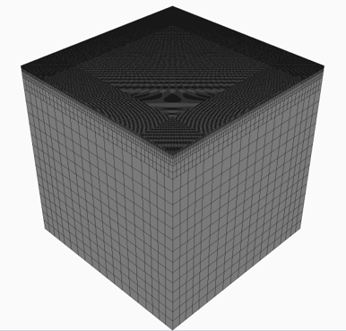

    • Coarsening generations – This sets the number of allowable adaptive mesh coarsening levels from the finest element size. This is a powerful tool to drastically reduce the mesh density to represent a geometry in voxel form and speed up simulation time by grouping together smaller elements into larger elements. Simulation Utility LT is limited to the values of 0 and 1 coarsening generations.
    • Layers per element – This establishes the finest possible element size. The base element size is established by multiplying the powder bed thickness, saved in the PRM file, by the Layers per element. For this example, the Ti-6Al-4V PRM file has a 0.040 mm layer thickness and 5 layers are grouped, so the finest possible element size is 0.20 mm (5 layers X 0.04 mm). The larger the number of elements grouped together, the larger the base element is, and thus the coarser the overall mesh will be. Simulation Utility LT allows a maximum of 20 Layers per element.

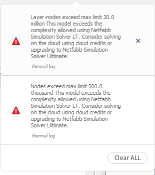

    At the end of the meshing process, the log will report two Errors, indicating that the mesh exceeds the limitations of Simulation Utility LT. A notification will also pop up in the upper right corner of the window, showing the same error messages. After the error message disappears, you can press the bell icon in the upper right of the interface to show the errors for the current simulation. The following errors are shown:
    • Layer-nodes exceed max limit of 20 million. A Layer-node is simply the number of layer groups X number of nodes of the final mesh.
    • Nodes exceed maximum limit of 500 thousand.

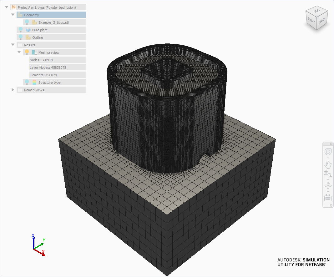

  11. Click OK to accept, and press Mesh Preview again to see if this brings the model within the acceptable meshing limits. Since a mesh already exists, a prompt will ask to overwrite those results. Click Yes to proceed.
    The meshing operation should take far less time. However, the resulting mesh, as indicated by the pop up error notifications, is still too dense, with 46 million layer-nodes. The number of nodes has fallen within the allowable bounds at 361 thousand nodes.

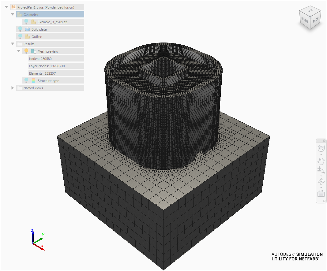

  13. Return to the Mesh Settings dialog again and change Layers per element to 6. Press OK to accept, and press Mesh Preview again to see if the new mesh setting brings the model within the acceptable meshing limits.
    Note upon meshing that neither the log file nor the error notification pop-up yield an Error. This set of operating conditions and mesh settings have brought the mesh settings within the bounds allowed by Simulation Utility LT, with 251 thousand nodes and 13 million layer-nodes. This geometry can now be solved to see how this component develops stress and distortion and various thermal effects using generic Ti-6Al-4V processing conditions.
