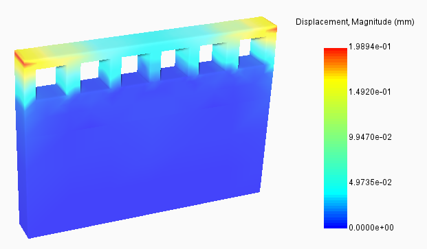

Original displacement results

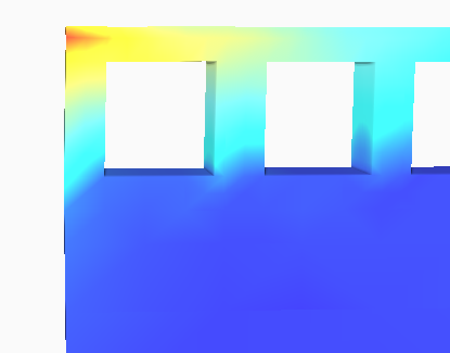

The figure shows simulation results using the file Example_12.stl. Note the areas of maximum displacement at the upper, outer corners of the original part. A closer look shows that these outer corners are displaced slightly inward, toward the center of the part.
When we prepare a compensated STL, we can expect to see the geometry offset in these corners so that displacement during the build will modify the geometry into the desired final shape.

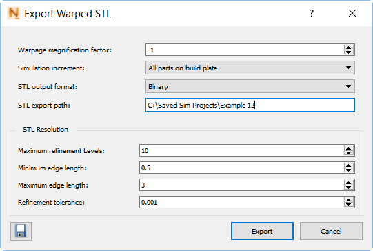

  1. Open the file Example_12.tivus in Simulation Utility, check that the light bulbs for Geometry and Build plate are turned off, then turn on the lightbulb for Displacement results. On the Results tab, click Warped STL . The Export Warped STL dialog opens.
    A positive value of 1 in the Warpage Magnification Factor field would export an STL file showing the predicted displacements. A value of -1 would produce a completely compensated STL, applying the full simulated displacements to the original STL dimensions. Values exceeding +/- 1 would produce an STL file with exaggerated displacements or compensation.
  2. In the Warpage Magnification Factor field, set a high negative value of -4, so the warping will be more visible in the results.
  3. Check that the STL export path is suitable, redirecting it if necessary, and then click Export.

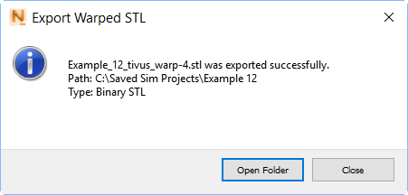

    The Export Warped STL dialog shows you the name of the warped STL file, which contains the warpage magnification factor in an extension of _warp-4.stl, and the path to the file.
  4. In the dialog, click Open Folder.
