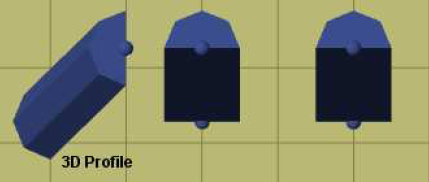

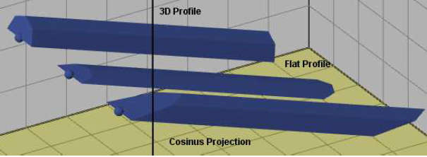

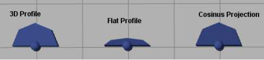

- 3D profile: Insert a profile at a right angle to the direction of the bar. This is similar to a cylinder connecting the two nodes it is attached to. In this case, the profile forms the cross-section. The top (+Y) of the profile is always oriented in the direction of the Z-axis running through the lower node. Thus, the bar may rotate if you move the nodes around these X-Y-coordinates.
- Flat profile: Insert a profile horizontally as slice in the X-Y-plane. These slices are then inserted to connect the nodes of the bar. Bars which are nearly horizontal will get a very flat shape.
- Cosinus projection: Insert horizontal slice-layers between the nodes of the bar. In contrast to the Flat profile, the profile is still inserted as cross section of the bar. Thus, the slice has the same X-Y-cross section as the profile. However, at its ends, the bar is not cut off in a right angle to its direction and is limited only by the Z-values of its nodes. All slice layers in between are inserted entirely.
