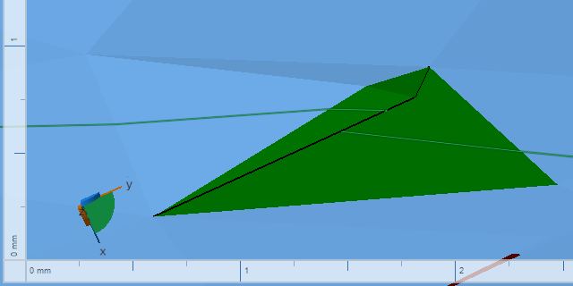

A set of triangles along a crease has been identified to overlap.
