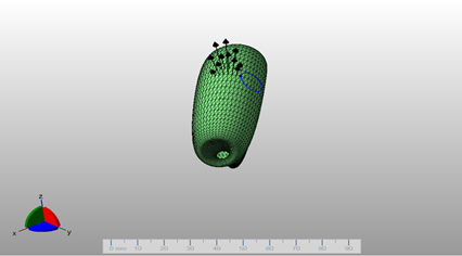

To Extrude a Part
Extrude surfaces on the current part to adjust the mesh.
  1. Select the part.
  2. Click Modify > Manipulate Mesh.
  3. Click Extrude along vertex normals.
  4. Either click an area on the part or click and drag to create a custom region to extrude.
  5. Click and drag the arrows that appear on the selected area to extrude the part.
