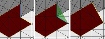

  1. From the main menu, click Mesh Edit > Add Triangles.
  2. Click an edge surrounding a hole. The selected edge is highlighted in blue.
  3. Hover your mouse over the other edges around the hole to preview the shape of the added triangle. The triangle preview is shown in green.
  4. Click an edge around the hole to add the triangle.
Left: First edge highlighted in blue. Middle: Preview of new triangle. Right: Resulting triangle.

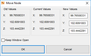

  1. Right-click the coordinates label to open the Move Node dialog:
  2. Enter X, Y, and Z coordinates.
  3. Click OK to move the node to the coordinate location specified.
