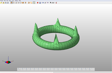

To Distort Vertices
Adjust the positioning of vertices on the mesh to distort the part.
Select the part.
Click
Modify
Manipulate Mesh
Click
Distort vertices
Click and drag a vertex on the part to distort the nearby vertices and therefore, the surface of the part.
