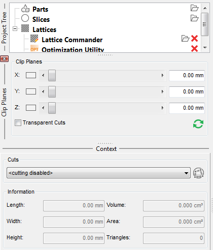

Rearrange or detach the views that make up Netfabb's window to suit your space and display preferences
Netfabb's user interface consists of several panes, or views, arranged in a window layout. The layout of the interface can be adjusted by resizing, repositioning, stacking, even detaching the different views that make up the interface. This can be especially useful on a multi-monitor workplace.
Click
and select from
Default,
Classic, and
Center.
splitter handle as desired.
The layout is saved when you close
Netfabb.
