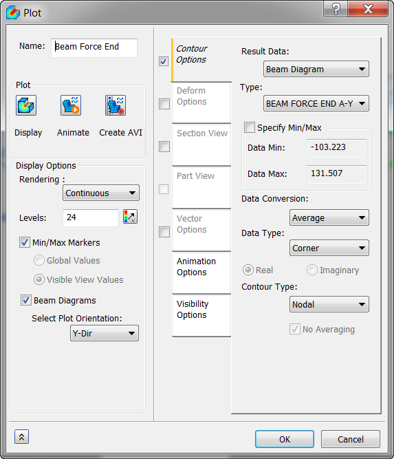

- Right-click
Results and click
New.
- On the
Contour Options tab, under
Result Data, select
Beam Diagram; under
Type, select
BEAM FORCE END A-Y PLANE 1.
- In the
Name field (top left), enter
Beam Force End.
- On the left side of the dialog box, make sure
Beam Diagrams is selected and
Select Plot Orientation is set to
Y-Dir.
- Uncheck the
Deform Options tab and click the
Display button.

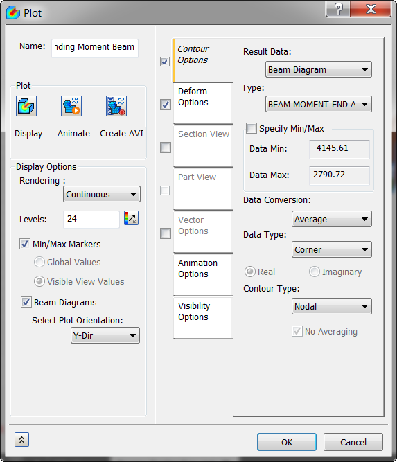

- On the
Result Data, select
Beam Diagram; under
Type, select
BEAM MOMENT END A-Z PLANE 1.
- In the
Bending Moment Beam.
- Make sure
Y-Dir.
- Click
Display.
