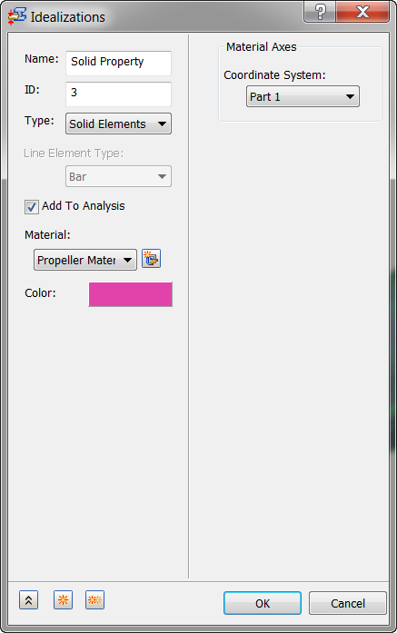

  2. In the Model tree, right-click on Idealizations and choose New.
  3. Rename the property to Solid Property.
  4. Select Solid Elements from the Type drop-down menu, and ensure that Material is set to Propeller Material. Accept the other defaults.
  5. Click OK to create the property.
