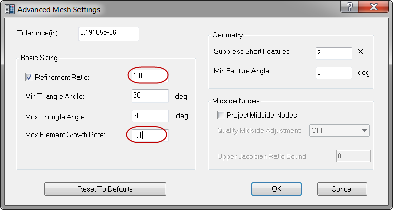

  3. Click the Settings button.
  4. Change the Refinement Ratio to 1.0.
  5. Change the Max Element Growth Rate input to 1.1.
  6. Click OK in the Advanced Mesh Settings dialog.
  7. Click OK once more in the Mesh Settings dialog. The meshed model should look as shown below.
The advanced settings allowed you to get a more uniform mesh density without having extra refinements and element growth.
