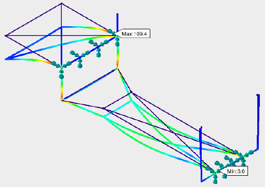

  3. Switch back to the iLogic browser, right-click in the white space of the browser and choose Run All Rules.
  4. If you receive a warning about multiple idealizations, click OK.
  5. Click OK when the solution is complete to view the contour plot.
