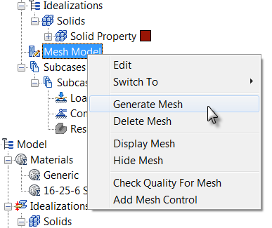

Define the Mesh
  1. Right-click on Mesh Model and select Generate Mesh. This will generate a solid mesh with parabolic tetrahedron elements and a default size based on the object dimensions.
  2. The meshed model should look as shown below. (If you cannot see the mesh, right-click anywhere in the tree window and select Default Settings. Go to Display Options, and select the checkbox next to Mesh Model.)
