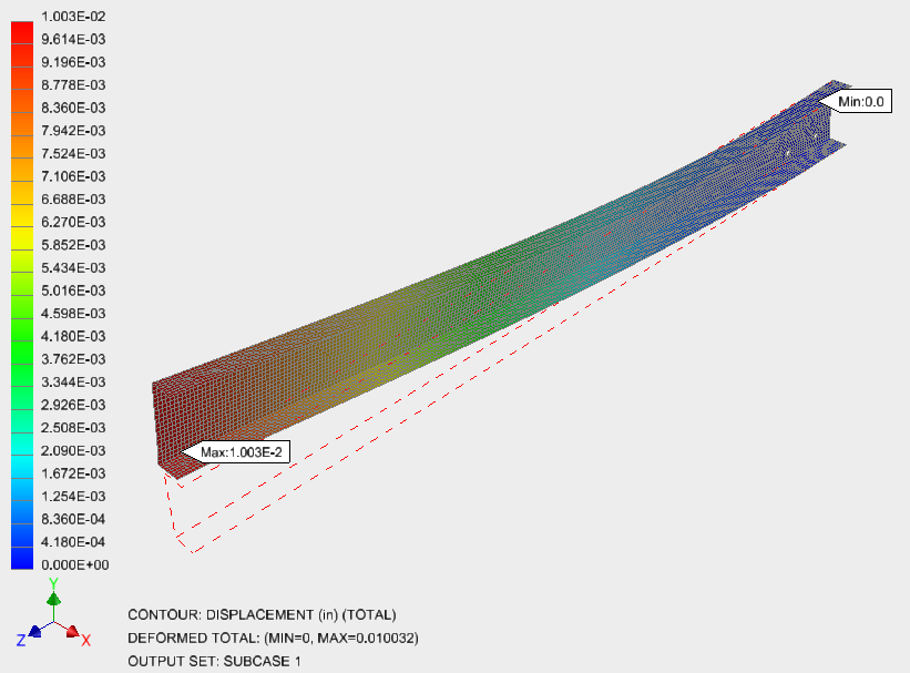

  1. When the analysis completes, double-click on Displacement under Subcase 1 to see the deformed and contour plot of the beam under the Y Displacement load. Loads and constraints are turned off for image clarity. You can do this by right-clicking the Loads and Constraints nodes and selecting Hide All from the drop-down list.

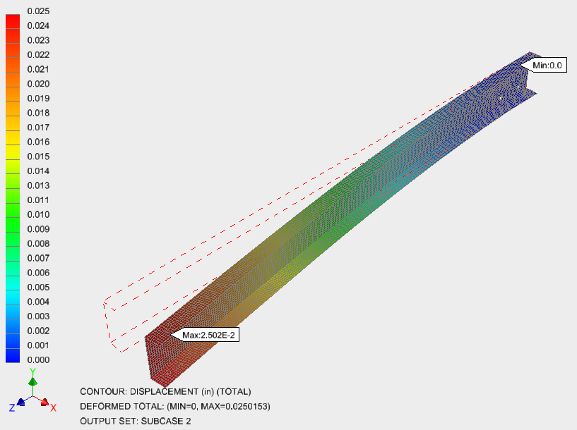

  2. Review the deformed and contour plot of the beam under the X Displacement load by double-clicking the Displacement results under Subcase 2.
