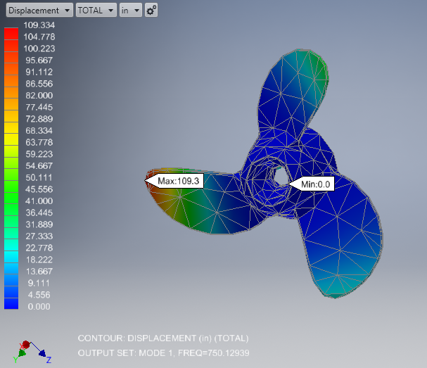

  3. Deselect the Deform Options checkbox, then click the Display button.

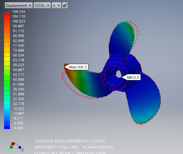

  4. The first and lowest frequency is about 750 Hz. In this case, it is a bending mode. Select the Deform Options checkbox, then click OK.
  5. The undeformed edges is overlaid on the contour to show the relative displaced shape. Here, the element edges are not displayed for visual clarity.
    In the first mode, the propeller blade bends out of the plane of the undeformed blades, displaying a bending mode shape.

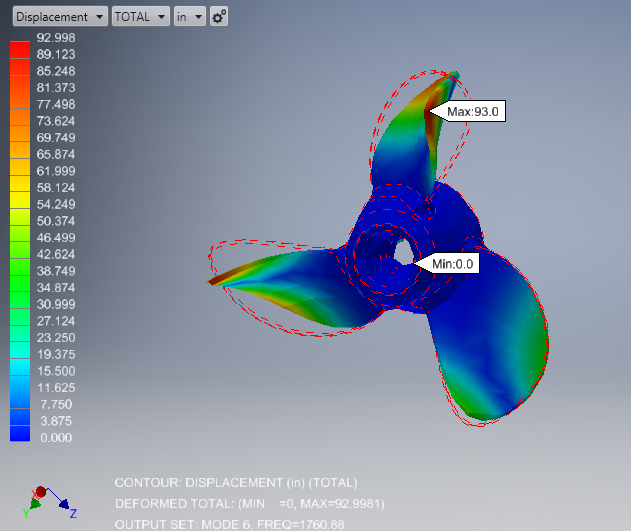

  6. Right-click Results > Edit, and under Subcases, select Mode 6, then click OK.
    Mode 6 displays a twisting mode. Again, displayed with the element edges turned off and alongside the undeformed edges to show relative displacements.
If the Max and Min labels are in the way, they can be turned off in the Display Options section of the Plot Property dialog along with the element edges.
