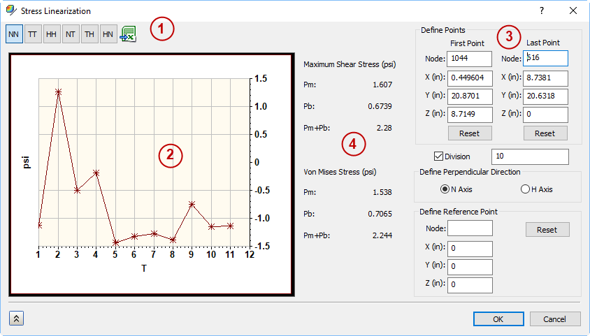

The Stress Linearization utility dialog includes the following controls, as numbered in the figure above:
  1. Local Stress Tensors: These selections allow you to choose which result to plot in the graph. The green button is used to save the numeric results in a .CSV file
  2. Stress Linearization Graph: The graph displays the local stress tensor results along the currently defined Stress Classification Line (SCL).
  3. Linearization Controls: The linearization controls allow you to specify the first and last point to define the SCL. You can also define the orientation of the local stress tensor graph.
  4. Stress Linearization Results: Results are displayed for both the Maximum Shear Stress and the Von Mises Stress:
    • Pm: The general primary membrane stress intensity for the current SCL.
    • Pb: The primary bending stress intensity for the current SCL.
    • Pm + Pb: The total primary stress for the current SCL (sum of the primary bending and primary membrane stresses).
