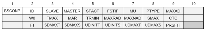

BSCONP
Surface Contact Parameters
Description: Defines the parameters for a surface contact region.
Format:
Example:
Field Definition Type Default
ID Contact region identification number. Integer > 0 Required
SLAVE Slave region identification number. Integer > 0 Required
MASTER Master region identification number. Integer > 0 Required
SFACT Stiffness scaling factor used to scale the penalty values determined automatically. See Remark 4. Real > 0.0 1.0
FSTIF Frictional stiffness for stick. See Remarks 5 and 12. Real ≥ 0.0 Model dependent
MU Coefficient of static friction. Real ≥ 0.0 0.0
PTYPE Penetration type. See Remarks 6 and 7.
0 = Disable contact
1 = Unsymmetric general contact (slave penetration only)
2 = Symmetric general contact
3 = Unsymmetric welded contact
4 = Symmetric welded contact
5 = Unsymmetric bi-directional sliding contact
6 = Symmetric bi-directional sliding contact
7 = Unsymmetric rough contact
8 = Symmetric rough contact
9 = Unsymmetric offset welded contact
10 = Symmetric offset welded contact
11 = RBE3 element
1 ≤ Integer ≤ 11 1
MAXAD Maximum activation distance. See Remark 8. Real ≥ 0.0 or AUTO See Remark 8
W0 Penetration surface offset. See Remark 9. Real 0.0
TMAX Maximum allowable penetration used in the adjustment of penalty values normal to the contact plane. A positive value activates the penalty value adjustment. See Remark 10. Real ≥ 0.0 See Remark 10
MAR Maximum allowable adjustment ratio for adaptive penalty values K and FSTIF. See Remark 11. Real > 1.0 100.0
TRMIN Fraction of TMAX defining the lower bound for the allowable penetration. See Remark 12. 0.0 ≤ Real ≤ 1.0 0.001
MAXRAD Maximum radial activation distance. See Remark 13. Real ≥ 0.0 0.0
MAXNAD Maximum normal activation distance. See Remark 13. Real ≥ 0.0 0.0
SMAX Maximum allowable slip used in the adjustment of penalty values parallel to the contact plane (FSTIF). A positive value activates the penalty value adjustment. See Remark 14. Real ≥ 0.0 0.0
CTC Contact thermal conductance. See Remark 15. Real ≥ 0.0
FT Failure theory. The following weld bond failure theories are allowed.
WFM for the Weld Failure Model
CZM for the Cohesive Zone Model
Character or blank WFM
SDMAXT Tensile stress of the weld bonding material when damage initiates. See Remark 16. Real ≥ 0.0 or blank 0.0
SDMAXS Shear stress of the weld bonding material when damage initiates. See Remark 16. Real ≥ 0.0 or blank 0.0
UDINITT Separation normal to the master weld surface when bond damage initiates. See Remark 16. Real ≥ 0.0 or blank 0.0
UDINITS Slip tangential to the master weld surface when bond damage initiates. See Remark 16. Real ≥ 0.0 or blank 0.0
UDMAXT Separation normal to the master weld surface when bond damage results in complete failure. See Remark 16. Real ≥ 0.0 or blank 0.0
UDMAXS Slip tangential to the master weld surface when bond damage results in complete failure. See Remark 16. Real ≥ 0.0 or blank 0.0
PRSFIT Press fit option, one of the following character variables: YES or NO. See Remark 17. Character NO
