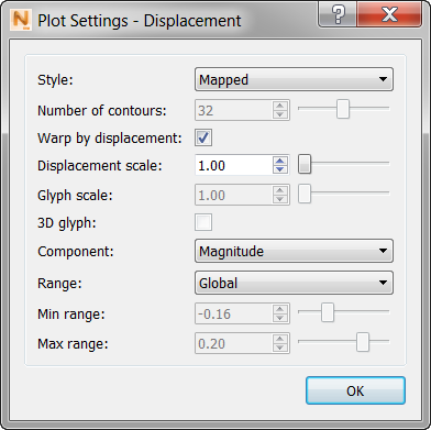

Click
Plot Settings to open a dialog in which to control how the results are graphically represented in the display.
Experiment with these to see which settings provide the best display of the gradient for each part. Three Style options are available:
- Mapped is the most commonly used, as it shows a smooth color gradient. If you select
Warp by displacement, it will warp the visible results by the displacement vector. For a true depiction of modeled distortion leave the default value of 1.00. You can also move the
Displacement scale slider to see the displacement value exaggerated for greater visibility of parts with small distortion.
- IsoSurface can show temperature gradients well, and you can adjust the number of contours using the slider bar, up and down arrows, and typing directly into the dialog box.
- Vector displays small arrows, known as glyphs, on the part and build plate to show the direction and degree of particle deformation. This option is only available for vector results, such as Displacement. You can use the Glyph Scale controls to exaggerate the size of the glyphs by the multiple chosen with by this option. By default the display shows 2D glyphs, but you can change to 3D vector arrows by selecting the 3D glyph box.
The
Component options vary for different result types. For example, by default, the magnitude of displacement is shown in three dimensions. To display a single X, Y, or Z component of displacement, select the axis from the Component menu.
Three
Range options are available:
- Global – This default option adjusts the scale to encapsulate the minimum and maximum values of the chosen results type over the entire history of the simulation.
- Local
– This option adjusts the scale to the local increment minimum and maximum values.
- Specified – This option allows you to set the minimum and maximum range values manually.
