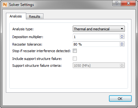

Solver Settings
Analysis tab
Analysis Type can be either Thermal only or both Thermal and Mechanical.
Use the Deposition Multiplier to increase the timing so as to add the time required to build multiple identical parts on the build plate. For example, if there are 12 identical parts on the build plate, and you want to simulate only 1 of the parts, enter a value of 12 for a machine with a single laser. Non-integer values are allowed for the simulation of multiple non-identical parts. If multiple lasers have been enabled in the Machine settings the system automatically adjusts the Deposition Multiplier setting to adjust the deposition time for multiple parts and multiple lasers.
Recoater Tolerance is used to set the minimum required clearance between the previous build and the recoater blade. The default value of 80% means that the recoater blade can safely deflect upward into 20% of the next layer, but if it goes higher, a Recoater Clearance warning is issued. For more information, see About Recoater Tolerance.
Stop if Recoater Interference Detected ends the simulation if the built part deflects upward far enough to exceed the specified Recoater Tolerance.
If Include Structure Failure Criteria is selected, the simulation will include warnings when the stress experienced by a support structure element exceeds the Support Structure Failure Criteria. This activates the next field, Support Structure Failure Criteria where the failure stress value should be entered in MPa.
