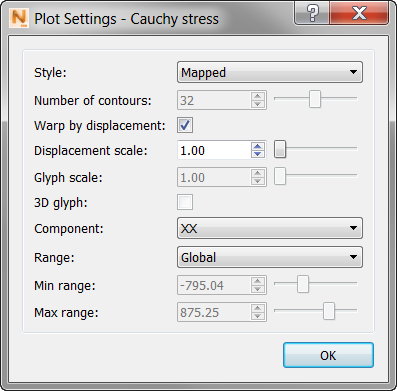

  8. Now view the Cauchy stress results. On the Results tab, click Plot Settings. Check that the Component value is XX to focus on the longitudinal stress, and change the Range setting to Global.

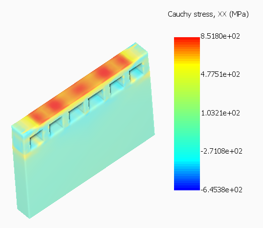

    The Timeline and time stamp for these results indicates that we are seeing the stress results of the heat treatment process. Stress is at the maximum at the first increment of heat treatment (shown below), then gradually relaxes.
  9. For a clearer view of the model, as shown above, right-click a Browser Result such as Cauchy stress, select Render Properties, and then in the dialog, deselect Element Edges.
