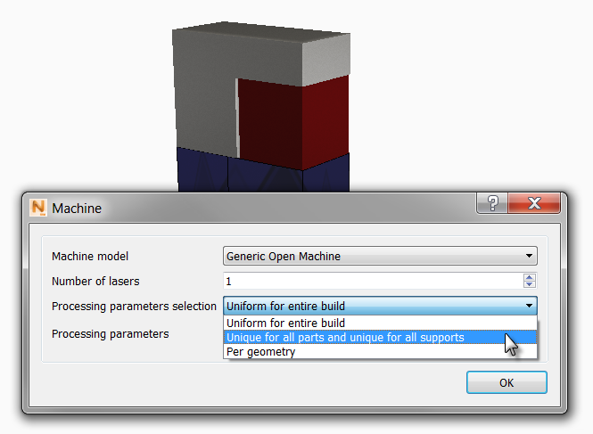

  3. Click Machine.
    Note the three available options for Processing parameters selection.
    • Uniform for Entire Build is the original option for applying a single PRM file to all parts and supports in the build.
    • Selecting Unique for all parts and unique for all supports opens separate Processing Parameters selection menus for parts and supports.
    • Note: Using multiple PRM files requires both PRMs to have the same material properties. For PRM files that include Lack of Fusion and Hot Spot information, the number and value of the Lack of Fusion temperatures, Hot spot temperatures, and Interlayer temperatures must be identical between the files.

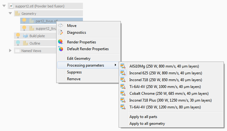

    • The Per geometry option provides the freedom to assign PRM files separately to each part and each support in the build by right-clicking the geometry in the Browser.
