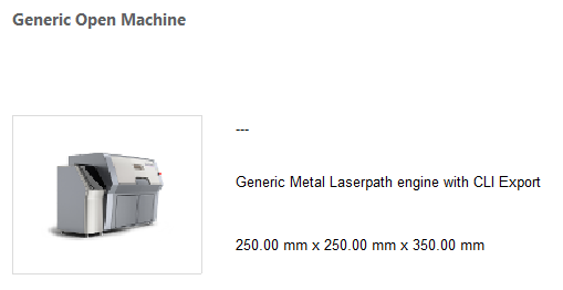

  2. If it's not already there, add Generic Open Machine to your list of machines.
    1. In the My Machines dialog, click the Add Machine button.
    2. In the Select a machine to add dialog, enter Generic in the top field, click the Filter icon, and select the A-Z results display.
    3. Under the Process Parameters list, click Generic Open Machine, then click the Add to My Machines button at the bottom of the dialog.
  3. In the My Machines dialog, with the machine selected, click Open.
    You should see Generic Open Machine selected at the top of the project model tree.

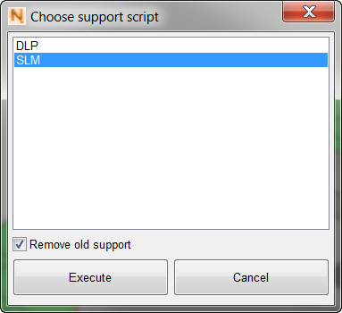

  8. At the bottom of the window, click Run Support Script, in the Choose support script dialog select SLM, and click Execute.
    The lattice-like supports are created.

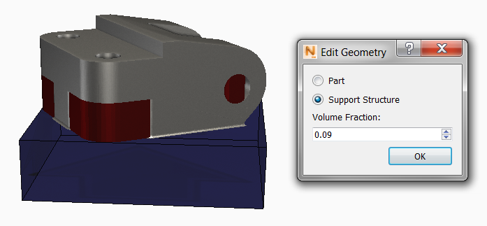

  12. In the Simulation Utility Browser, right-click on the support structure, which has a name that includes _hulledsupport_, and select Edit Geometry.
    One benefit of using Netfabb to generate supports appears here, in that the Volume Fraction is automatically calculated during support creation. Volume fraction is the amount of the support volume that is occupied by physical structures rather than empty space. Leave the existing value unchanged.

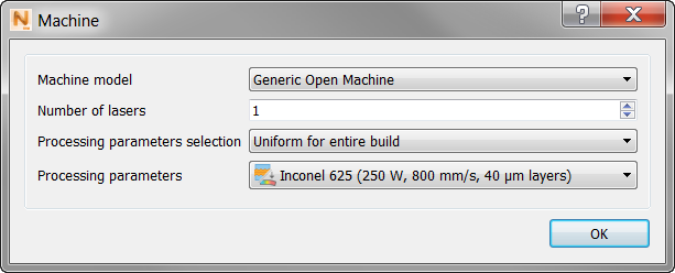

  14. In the Machine dialog, set Machine Model to Generic Open Machine and Processing Parameters to Inconel 625.

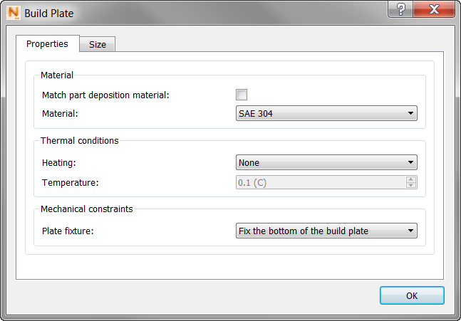

  16. In the Build Plate dialog, click the Properties tab; here deselect Match part deposition material and set Material to SAE 304.

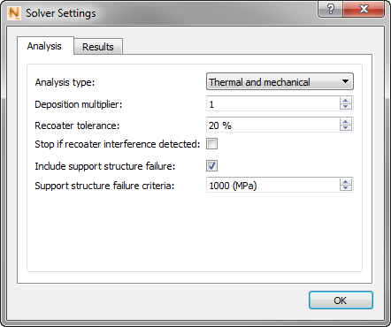

  18. Click OK, then click Solver Settings. On the Analysis tab, select Include support structure failure, and set the failure criteria to 1000 MPa.
  19. Click Solve to start the simulation, and save the project with a descriptive name.

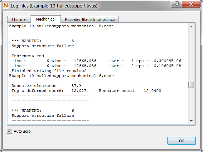

  20. Click Results tab > View Logs to read the solver output.
  21. In the Log Files window, click the Mechanical tab, and scroll down, looking for Warnings.
    You may see several warnings of support structure failure. These indicate that the support structure failure criteria, specified in MPa units in the Solver Settings, was exceeded during simulation.

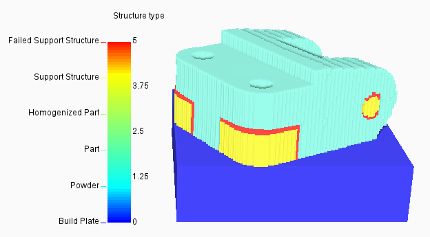

  22. In the Browser Results folder, use the light bulb icons to show the Structure Type results. In the Animation panel, move the increment slider to the right to view the last increment before build plate removal.
    The Structure type results are color coded into 6 different element types, and the failed support structures are clearly visible in red.

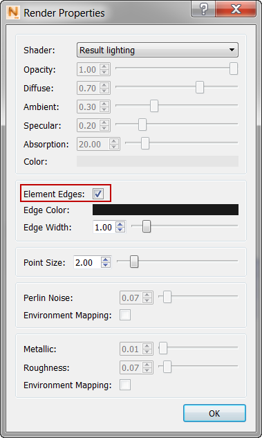

  23. If you want to turn off the element edges display for a clearer view, as shown above, right-click in the Results Browser, select Render Properties, and deselect Element Edges.

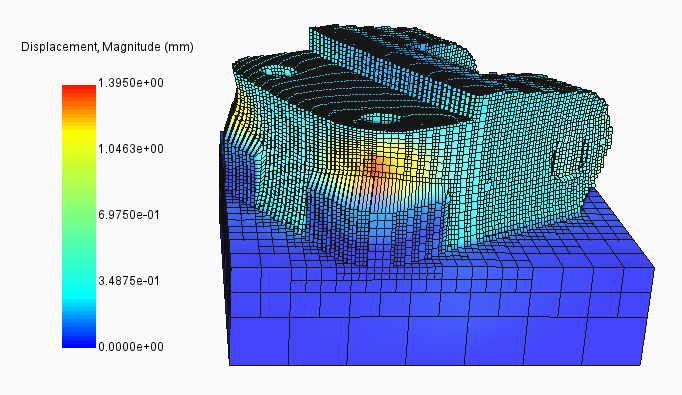

  24. Use the light bulb icons to show the Displacement results.

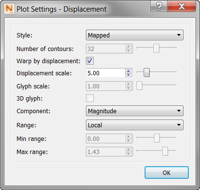

  25. Click Plot Settings .
  26. Select Warp by Displacement, and change the Displacement Scale to 5.0 to exaggerate the displacement five times. Click OK to exit the settings dialog.
    For this example you may want to turn the element edges back on in the Render Properties dialog. The warped displacement results with visible element edges should look similar to the figure below:
    Note that the elements at the support-part interface look distended. Rotate the part and zoom into the distended region.
    Observe the excessive displacement of the part at this location. You may want to go back to the Mechanical log file and make note of one or more specific time increments when the warnings of support structure failure occurred. You can enter those times into the Time field on the Animation panel of the Results tab to see the state of the build at each time.
