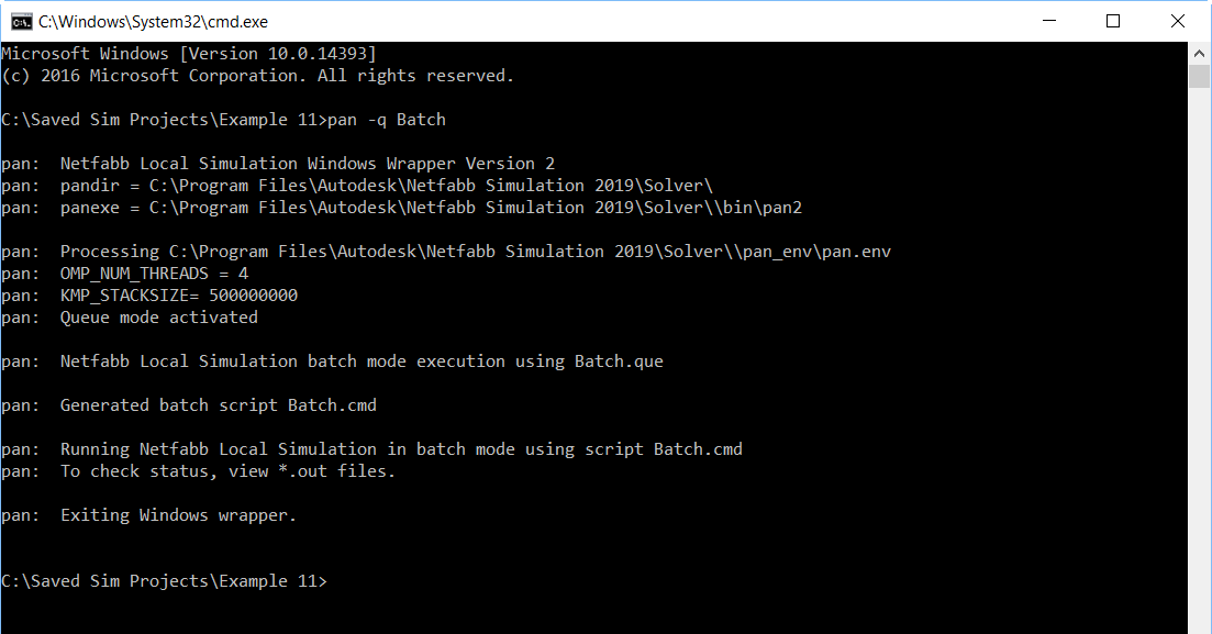

  15. To execute the batch command, type pan -q Batch from the command prompt, and then press Enter.
    pan is the solver executable, -q indicates a batch file will be used for the inputs, and Batch is the name of the .que file, without the file extension. The execution and output returned from the solver should look similar to the following:
    The solver ran the four simulations in sequential order. In the Example 11 folder, you should see .out, .case, and other output files for each simulation.
