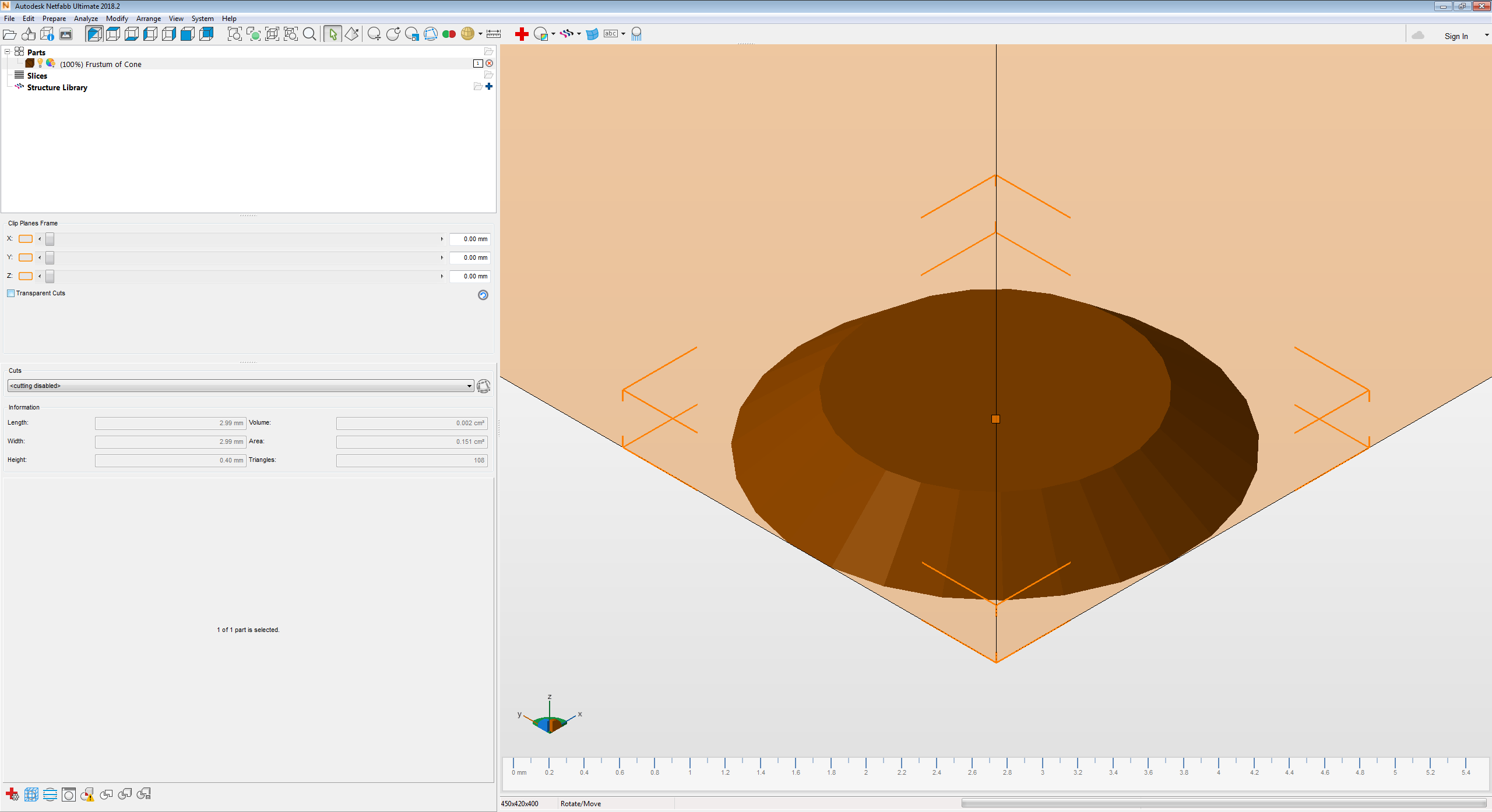

  2. Click File > Add Part and from the sample files subfolder Example_20, import the file Frustum of Cone.stl as shown below:

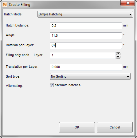

  6. Under Project Tree, Slices node, right-click Frustrum of Cone, then select Extras > Create Filling.
  7. In the Create Filling dialog, set the following values:
    • Hatch Distance: 0.2 mm
    • Angle: 11.5°
    • Rotation per Layer: 67°
    Leave the other options at default values, and click OK.
  8. This operation fills in the contours with hatches. Again use the Play button or the vertical scroll bar to review the hatches created.
