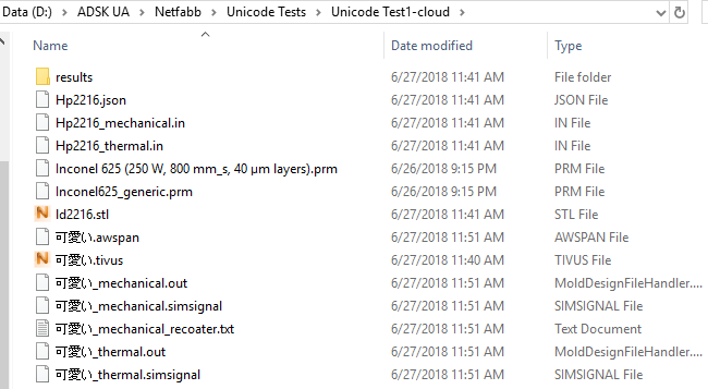

If the path to a Unicode file is all in ASCII characters, some of the output files retain the Unicode name, as shown below:
Other files have the Unicode string replaced with an ASCII string. Note that the input files, _thermal.in and _mechanical.in, must always use ASCII names, not Unicode.

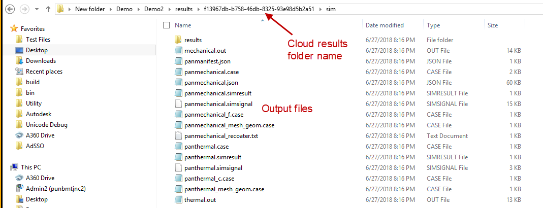

Whether Unicode names are involved or not, the output of a cloud solve is delivered to your computer in the project folder you initially designated. The results folder contains a folder with a long alphanumeric name, such as the example in the navigation bar at the top of the figure below:
In the sim subfolder, the output files have standard names, as shown above.

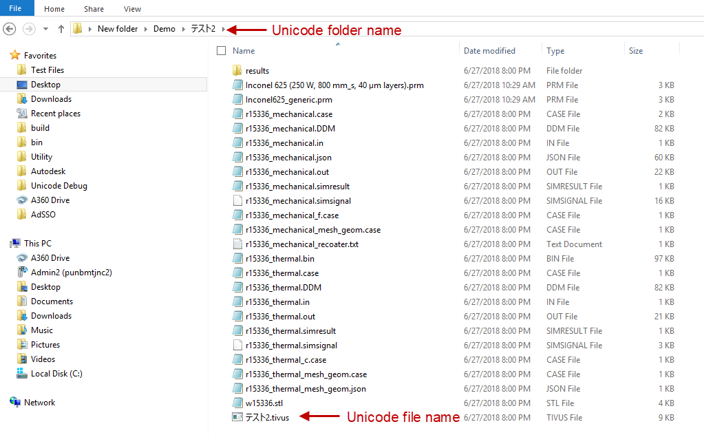

The figure below shows the files produced from a local solve with Unicode (Japanese) names for the TIVUS file and the project folder.
Note that for the input and output files, the Unicode characters have been replaced with a random ASCII string, r15336, except for the STL file which has a slightly different string, w15336. The STL file is included in the thermal.in and mechanical.in ASCII files, so it must have an ASCII name. If the project includes multiple STL files, Simulation Utility provides them with unique names.
If the file path includes Unicode text, then for a local solve the job is executed in C:\ProgramData\Autodesk\Simulation Utility for Netfabb 2019 (or Simulation Utility LT for Netfabb 2019). The output files are copied back to the project folder where the TIVUS file is saved, and the files are deleted from the C:\ProgramData\Autodesk\ directory.
