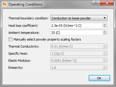

  4. Open Operating Conditions and set Thermal boundary condition to Conduction to loose powder. Click OK.

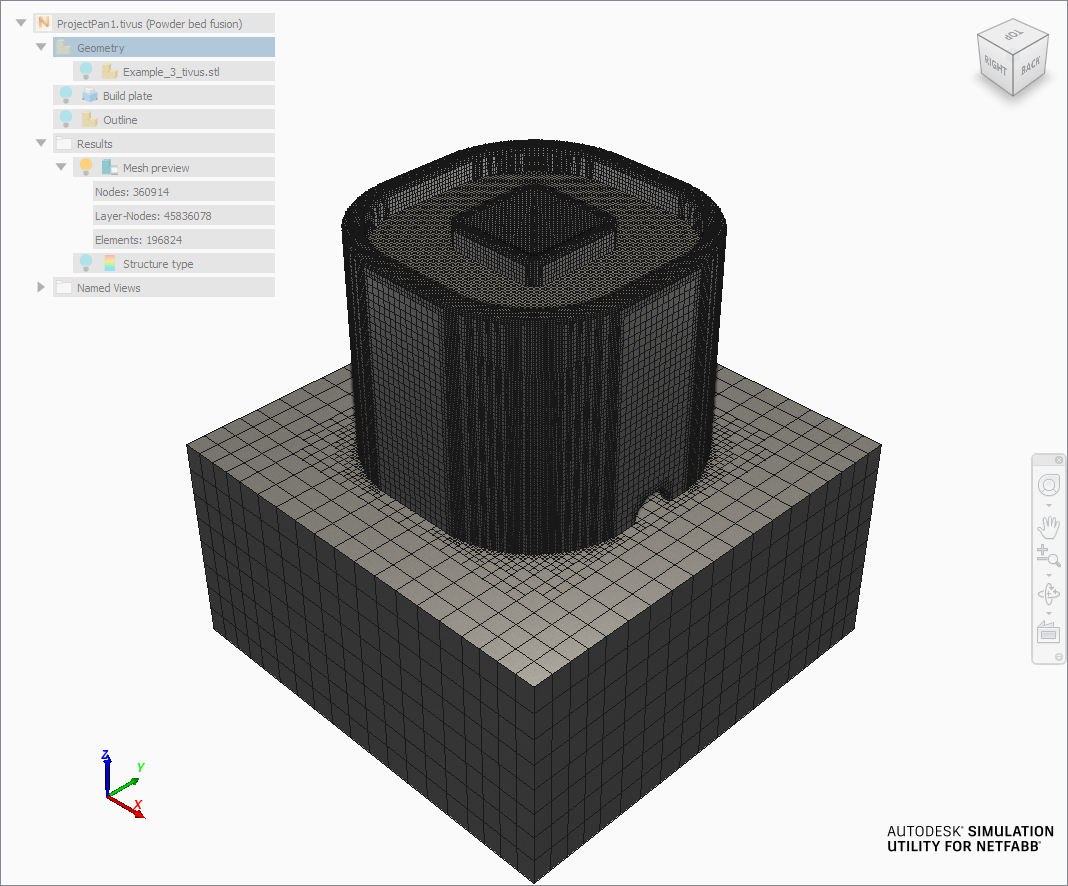

  11. Click OK to accept, and press Mesh Preview again to see if this brings the model within the acceptable meshing limits. Since a mesh already exists, a prompt will ask to overwrite those results. Click Yes to proceed.
    The meshing operation should take far less time. However, the resulting mesh, as indicated by the pop up error notifications, is still too dense, with 46 million layer-nodes. The number of nodes has fallen within the allowable bounds at 361 thousand nodes.

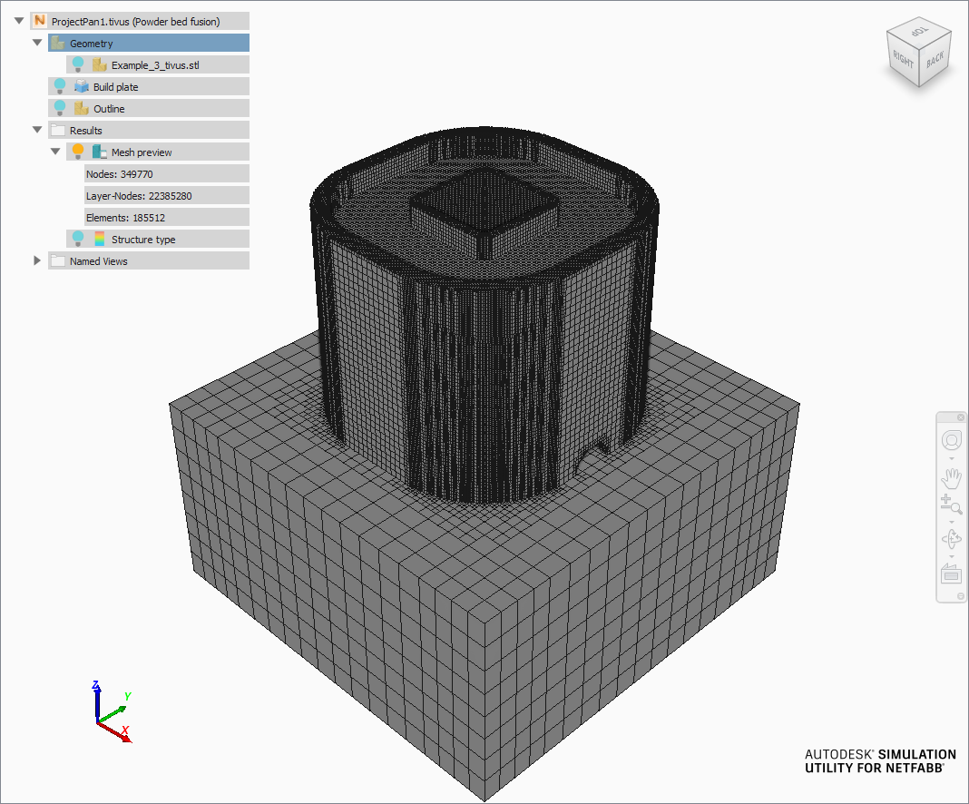

  12. Return to the Mesh Settings dialog and set Coarsening generations to 1. Press OK to accept, and press Mesh Preview again to see if the new mesh setting brings the model within the acceptable meshing limits.
    The resulting mesh is just over the allowable bounds, with 22 Million layer-nodes.

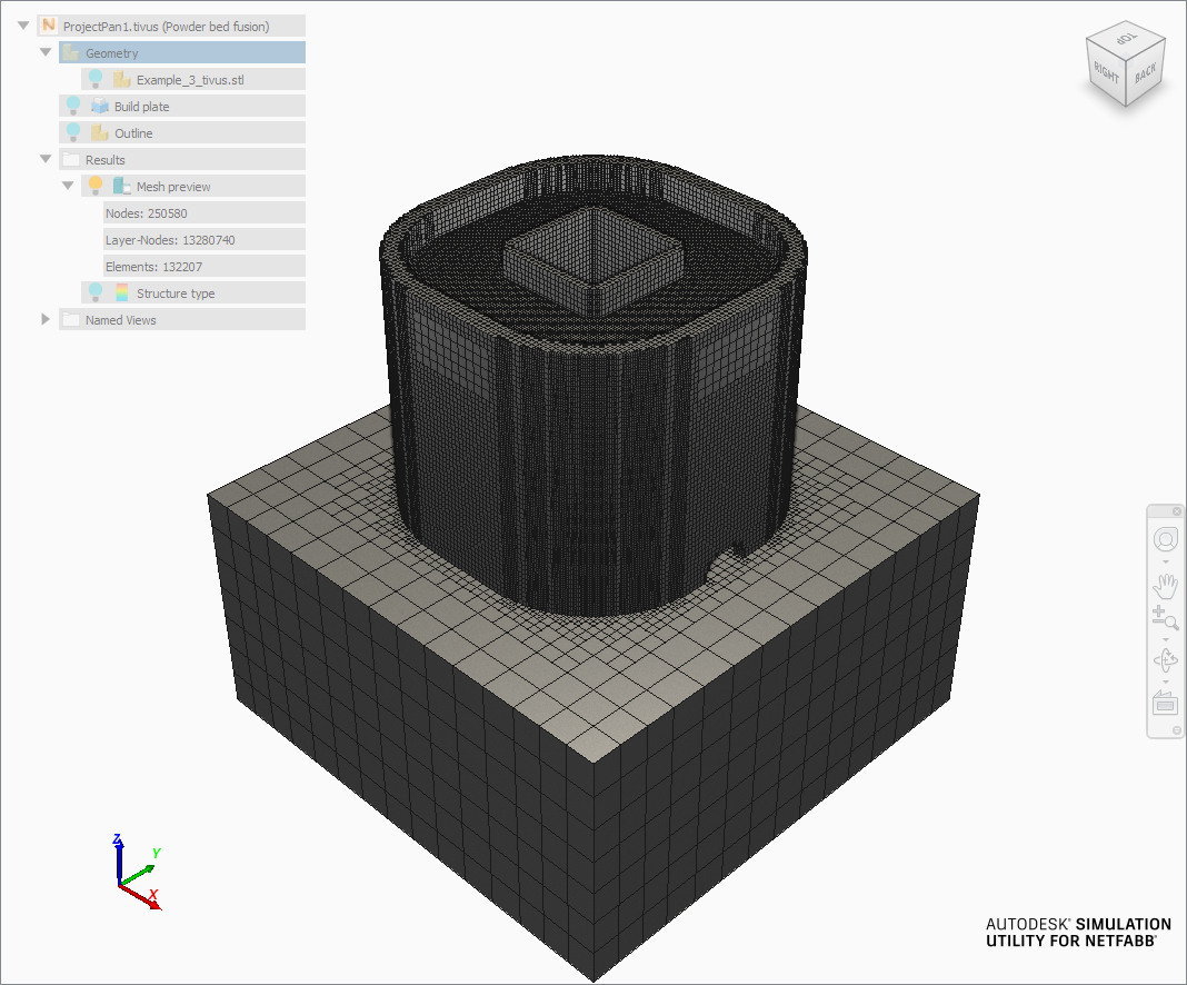

  13. Return to the Mesh Settings dialog again and change Layers per element to 6. Press OK to accept, and press Mesh Preview again to see if the new mesh setting brings the model within the acceptable meshing limits.
    Note upon meshing that neither the log file nor the error notification pop-up yield an Error. This set of operating conditions and mesh settings have brought the mesh settings within the bounds allowed by Simulation Utility LT, with 251 thousand nodes and 13 million layer-nodes. This geometry can now be solved to see how this component develops stress and distortion and various thermal effects using generic Ti-6Al-4V processing conditions.
