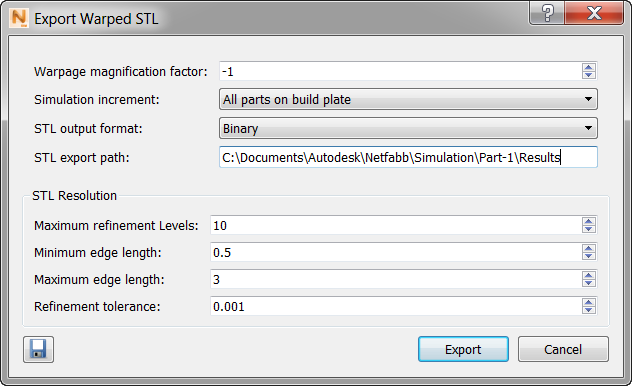

Warpage magnification factor
This specifies the value to multiply all simulated displacements applied to the reference geometry. Negative values are used to create compensated STLs and positive values are used to create distorted STLs.
Simulation increment
Specify which simulation increment to produce the warped STL from, which may be:
Warpage occurs after the part has been cooled to the final temperature and any optional heat treatment schedule.
The two latter options, after build plate removal, should only be enabled if in Solver Settings > Results tab, Structural Plasticity has been set to On. Otherwise, the excessive distortion after build plate removal will create an overly warped or compensated STL file.
STL output format
Choose either the Binary format for a smaller file, or ASCII, which produces a human-readable file.
STL export path
Use the STL export path field to specify a destination directory for the warped STL. The path cannot include any Unicode characters.
Maximum refinement levels
Specify the maximum number of times an edge can be subdivided. Increasing this value will provide more accurate representation of the modeled distortion, but will result in slower file generation and a larger STL file. For large, complex geometries it is recommended to decrease this from the default value.
Minimum and maximum edge length
Specify the shortest and longest edges allowed in the exported STL, respectively. Decreasing either edge length will take longer to export and produce a larger STL file. Increasing the allowable edge lengths will produce a smaller STL file, but may result in a poorer representation of the model results.
Refinement tolerance
Set a value to indicate how accurately the warped STL must represent the actual simulation results. Lower tolerance values will produce more accurate results, but at the expense of larger files and slower generation times.
If you click the Export icon in the lower left, a file <part_name>_tivus_warp#.in is generated to your project folder, with # replaced by the Warpage Magnification Factor. This file can be used to generate a warped STL from the command line. Consult the Local Simulation help to learn how to use this file.
When you click the Export button in the lower right, three files are exported to the destination specified as the STL export path:
