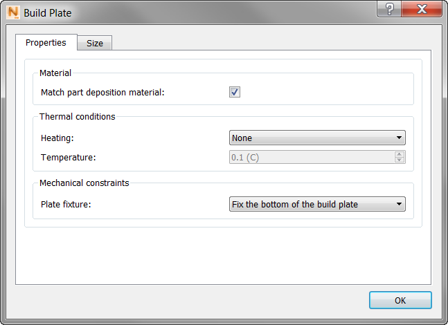

Set the build plate properties and dimensions in the Build Plate dialog.
On the Properties tab, if you deselect Match Part Deposition Material, a Material field appears, in which you can choose a different material from the list.
Heating:
Plate Fixture:
These constraints options are illustrated in the figures below. The constraints during processing are shown in the top figure, with the base of the build plate being well constrained in the Z direction, as well as constraints in the X, Y, and Z direction at the center of the build plate. The lower figure shows the mechanical model constraints with the Simulate Bolt Release, after process modeling completes, cool down and the optional Structural Plasticity step. This option leaves just the constraints at the center of the build plate base, allowing the rest of the build plate to distort. These are also the same constraints used for the Fix the Center of the Build Plate option during the entire process.

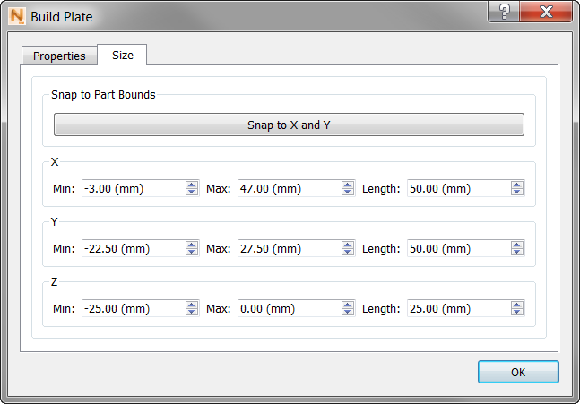

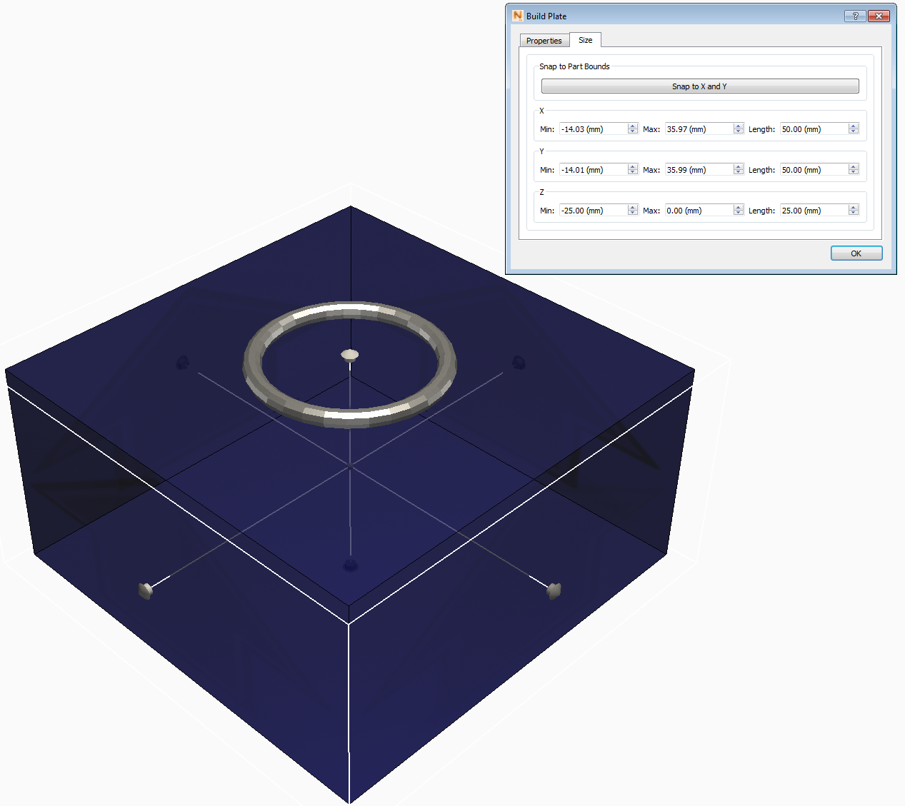

Adjustment fields for the X, Y, and Z dimensions are available on the Size tab. The Length settings for X and Y can be used to define a custom build plate region to mesh while the Z control for setting the build plate thickness. If you want the build plate to be a rectangle the same size as the model's bounding box, click Snap to X and Y. Using these settings will override the build plate size established using the Machine model setting in the Machine dialog.
While the Build Plate dialog is open, a knob appears on each axis that you can use to manually adjust the build plate dimensions.
