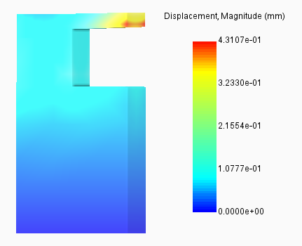

  8. To see this point in the animation, go to the Results tab > Animation panel, and move the time slider to increment 12, 6711.15 seconds.
    In the Displacement results at this time, you can see the upward deflection of the overhang.

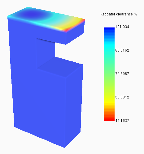

    You may also want to view the recoater clearance results:
    Note the inverted color spectrum in the legend for these results, reflecting the fact that high percentage values for recoater clearance are safe, while low values are risky.
    Seeing clear evidence of interference, an engineer could decide to add support structures to prevent distortion of the part and damage to the recoater blade.
