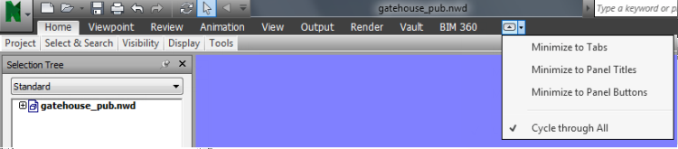

There are two buttons to the right of the ribbon tabs, that allow you to choose the ribbon toggle and ribbon minimize states.
- Click the drop-down arrow
in the ribbon tab bar.
- Select one of four minimize ribbon states:
- Minimize to Tabs: Minimizes the ribbon so that only tab titles are displayed.
- Minimize to Panel Titles: Minimizes the ribbon so that only tab and panel titles are displayed.
- Minimize to Panel Buttons: Minimizes the ribbon so that only tab titles and panel buttons are displayed.
- Cycle Through All: Cycles through all four ribbon states in the order, full ribbon, minimize to panel buttons, minimize to panel titles, minimize to tabs.
