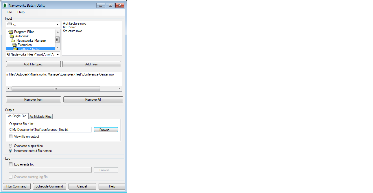

To generate a list of all design files used in the current model
- In Autodesk Navisworks application, open the desired Autodesk Navisworks file, and click Home tab
Tools panel
Batch Utility
- The Autodesk Navisworks Batch Utility dialog box is displayed, and the path to the current model is automatically added to the Input area of the dialog box.
- In the Output area, As Single File tab, click the Browse button.
- In the Save Output As dialog box, browse to the desired folder, and enter the name for the text file.
- In the Save as Type drop-down list, select the File List (*.txt) option, and click Save.
- In the Autodesk Navisworks Batch Utility dialog box, click the Run Command button.
Tip: If you want to automatically open the file as soon as it’s been created, select the View File on Output check box before you click the Run Command button.
