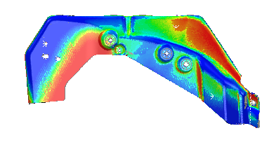

- While viewing the point-cloud from above, select a point, for example:
 A plane is fitted to the selected point and all points below the plane are selected.

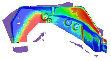

- If the plane is not fitted high enough to select all the unwanted points, for example:
 In the
		  Defined Plane Tolerance dialog, increase the
		  Defined plane tolerance.
