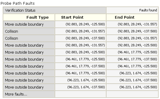

While probe path colours in the CAD view and verification status icons in the inspection sequence highlight the fault type of the first fault detected in a probe path, you can see more detailed information about probe path verification faults using the Info tab.
To view verification faults in the Info tab:
For example:
Up to ten faults can be reported for each item. If more than ten faults are found, the tab displays More faults, but does not show the details.
